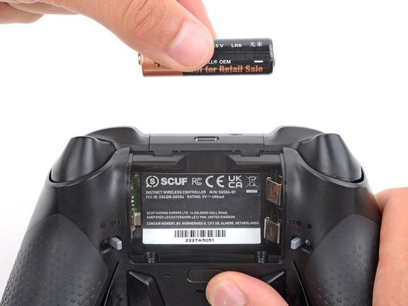

  4. Scuf Instinct Pro Buttons Replacement, Remove the batteries: stap 4, afbeelding 1 van 3 Scuf Instinct Pro Buttons Replacement, Remove the batteries: stap 4, afbeelding 2 van 3 Scuf Instinct Pro Buttons Replacement, Remove the batteries: stap 4, afbeelding 3 van 3
    • If your batteries are starting to corrode, clean the contacts and replace the batteries.
    • Use your fingers to remove the batteries.
    • During reassembly, insert the batteries so their positive (+) and negative () ends match up with the markings on the battery contacts.

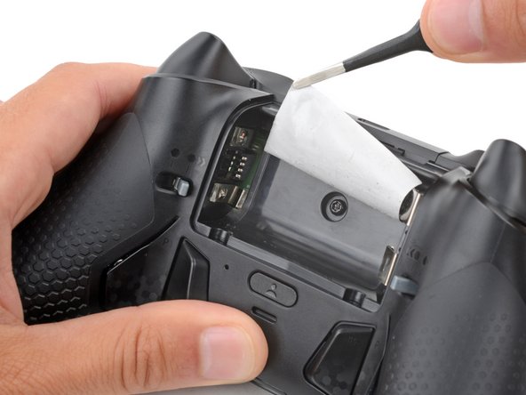

  5. Scuf Instinct Pro Buttons Replacement, Heat the battery sticker: stap 5, afbeelding 1 van 2 Scuf Instinct Pro Buttons Replacement, Heat the battery sticker: stap 5, afbeelding 2 van 2
    • The sticker in the battery recess hides a back cover screw.
    • If you don't care about damaging the sticker, you can puncture through the center and skip the next step.
    • Use a hair dryer to heat the sticker and soften the adhesive securing it.
    • The sticker can be peeled without heating, but you risk tearing it.
  6. Scuf Instinct Pro Buttons Replacement, Peel up the battery sticker: stap 6, afbeelding 1 van 3 Scuf Instinct Pro Buttons Replacement, Peel up the battery sticker: stap 6, afbeelding 2 van 3 Scuf Instinct Pro Buttons Replacement, Peel up the battery sticker: stap 6, afbeelding 3 van 3
    Gereedschap gebruikt in deze stap:
    • Use the point of a spudger to push up a corner of the sticker until you can grab it with a pair of blunt nose tweezers.
    • Use your tweezers to peel up the sticker until the back cover screw is accessible.

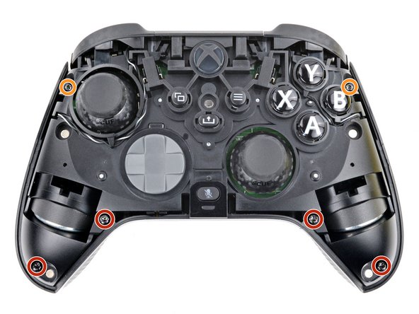

    • Use a T8 Torx screwdriver to remove five 9.3 mm‑long screws securing the midframe:
    • One back cover screw
    • Four screws on top of the midframe
    • Use a T6 Torx screwdriver to remove the two 9.3 mm‑long screws securing the midframe.

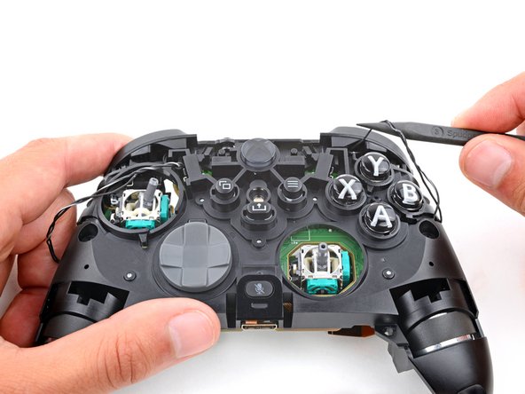

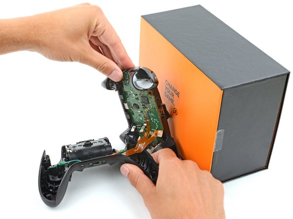

  9. Scuf Instinct Pro Buttons Replacement, Prop up the midframe: stap 9, afbeelding 1 van 3 Scuf Instinct Pro Buttons Replacement, Prop up the midframe: stap 9, afbeelding 2 van 3 Scuf Instinct Pro Buttons Replacement, Prop up the midframe: stap 9, afbeelding 3 van 3
    • Put a box or a stack of books to the right of the controller so you can prop up the midframe while disconnecting its ribbon cable.
    • Secure the back cover with one hand, and use your other hand to grip the midframe's left edge.
    • Lift the midframe and rotate it over the right edge of the back cover, so the midframe's right edge is on your workspace.
    • Prop the midframe up, being careful not to strain the ribbon cable.

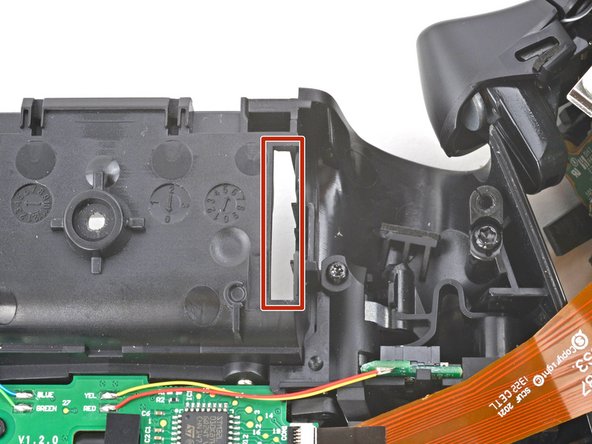

  10. Scuf Instinct Pro Buttons Replacement, Reassembly information: stap 10, afbeelding 1 van 3 Scuf Instinct Pro Buttons Replacement, Reassembly information: stap 10, afbeelding 2 van 3 Scuf Instinct Pro Buttons Replacement, Reassembly information: stap 10, afbeelding 3 van 3
    • During reassembly:
    • Guide the battery connectors on the midframe through their slot in the back cover.
    • Make sure the contacts slide into their grooves in the battery recess. If they aren't in the correct spot, the controller won't receive power.

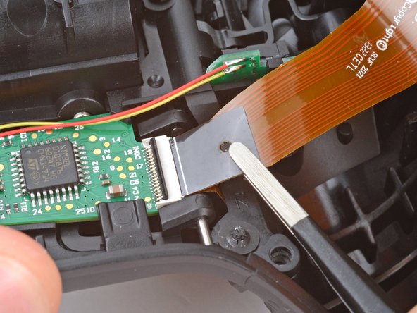

  11. Scuf Instinct Pro Buttons Replacement, Disconnect the midframe: stap 11, afbeelding 1 van 3 Scuf Instinct Pro Buttons Replacement, Disconnect the midframe: stap 11, afbeelding 2 van 3 Scuf Instinct Pro Buttons Replacement, Disconnect the midframe: stap 11, afbeelding 3 van 3

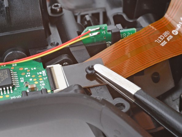

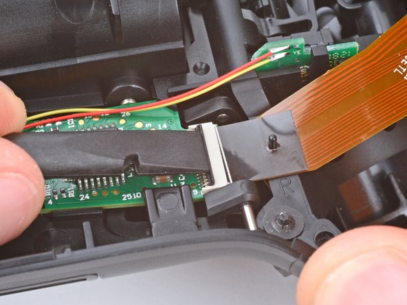

    • A very small rubber grommet secures the midframe's ribbon cable to a post on the right side of the back cover.
    • Use blunt nose tweezers to remove the grommet—don't lose it!

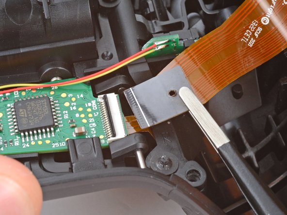

  12. Scuf Instinct Pro Buttons Replacement: stap 12, afbeelding 1 van 2 Scuf Instinct Pro Buttons Replacement: stap 12, afbeelding 2 van 2
    • Use the flat end of a spudger or a clean fingernail to lift the hinged locking flap on the midframe cable ZIF connector.

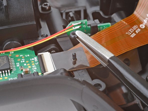

  13. Scuf Instinct Pro Buttons Replacement: stap 13, afbeelding 1 van 3 Scuf Instinct Pro Buttons Replacement: stap 13, afbeelding 2 van 3 Scuf Instinct Pro Buttons Replacement: stap 13, afbeelding 3 van 3
    • Use blunt nose tweezers to grip the black pull tab on the midframe cable.
    • Lift the midframe cable off its post and pull it straight out of its socket.
  14. Scuf Instinct Pro Buttons Replacement, Remove the midframe: stap 14, afbeelding 1 van 1
    • Remove the midframe.

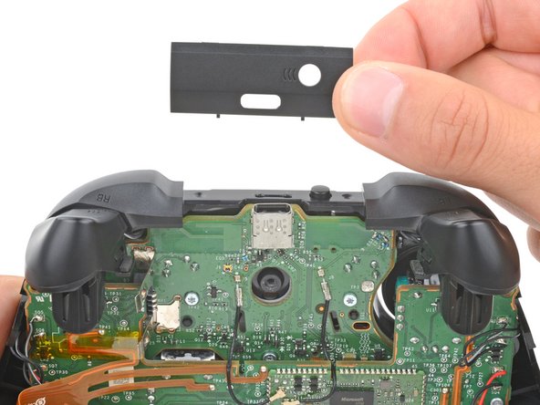

  15. Scuf Instinct Pro Buttons Replacement, Remove the USB‑C port cover: stap 15, afbeelding 1 van 3 Scuf Instinct Pro Buttons Replacement, Remove the USB‑C port cover: stap 15, afbeelding 2 van 3 Scuf Instinct Pro Buttons Replacement, Remove the USB‑C port cover: stap 15, afbeelding 3 van 3
    • The top of the USB‑C port cover is secured with a pair of plastic arms. The bottom is secured with plastic clips.
    • Rotate the underside of the USB‑C port cover up and away from the controller to release the bottom clips.
    • Unhook the plastic arms and remove the cover.

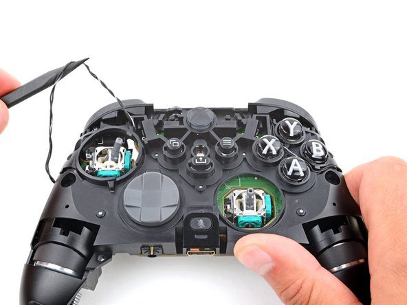

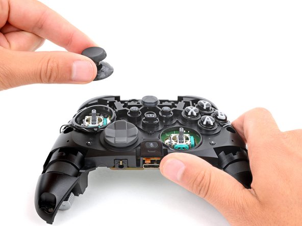

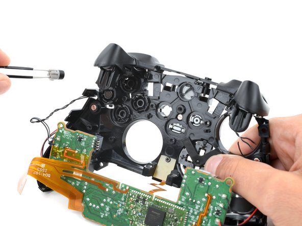

  16. Scuf Instinct Pro Buttons Replacement, Remove the thumbstick covers: stap 16, afbeelding 1 van 3 Scuf Instinct Pro Buttons Replacement, Remove the thumbstick covers: stap 16, afbeelding 2 van 3 Scuf Instinct Pro Buttons Replacement, Remove the thumbstick covers: stap 16, afbeelding 3 van 3
    • Firmly secure the controller with one hand, and use your other hand to lift the thumbstick covers straight off their modules.
    • This requires significant force. If you're having trouble, try wiggling the cover to help loosen it.
    • To install a thumbstick cover:
    • Place and rotate the cover on its module until it slides into place.
    • Firmly press down on the cover until it snaps into place or bottoms out.

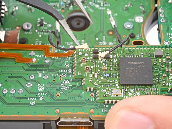

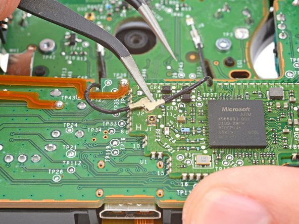

  18. Scuf Instinct Pro Buttons Replacement, Disconnect the thumbstick board: stap 18, afbeelding 1 van 3 Scuf Instinct Pro Buttons Replacement, Disconnect the thumbstick board: stap 18, afbeelding 2 van 3 Scuf Instinct Pro Buttons Replacement, Disconnect the thumbstick board: stap 18, afbeelding 3 van 3
    $3.99
    • Be very careful not to scrape off or damage any surface mounted components during this step.
    • Flip your controller over.
    • Insert an arm of your angled tweezers under the metal neck of one of the coaxial connectors and lift straight up to disconnect it from the thumbstick board.
    • Disconnect the other connector.
    • To reconnect coaxial connectors, hold each one in place over its socket and press down with the flat end of your spudger. The connector will snap into place.

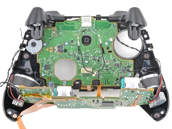

  19. Scuf Instinct Pro Buttons Replacement, Unfasten the thumbstick board: stap 19, afbeelding 1 van 2 Scuf Instinct Pro Buttons Replacement, Unfasten the thumbstick board: stap 19, afbeelding 2 van 2
    • Use a T6 Torx screwdriver to remove the two 7 mm‑long screws securing the thumbstick board.

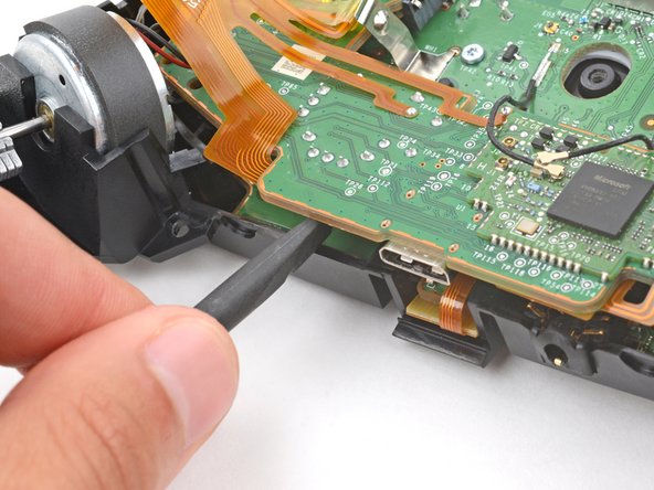

  20. Scuf Instinct Pro Buttons Replacement, Disconnect the thumbstick board: stap 20, afbeelding 1 van 3 Scuf Instinct Pro Buttons Replacement, Disconnect the thumbstick board: stap 20, afbeelding 2 van 3 Scuf Instinct Pro Buttons Replacement, Disconnect the thumbstick board: stap 20, afbeelding 3 van 3
    • The thumbstick and charging boards are connected with a socket.
    • Insert the flat end of a spudger between the bottom edge of the thumbstick board and midframe.
    • Twist the spudger to separate the boards.
    • During reassembly, gently push the thumbstick board onto the charging board until you feel the plug slide into the socket.

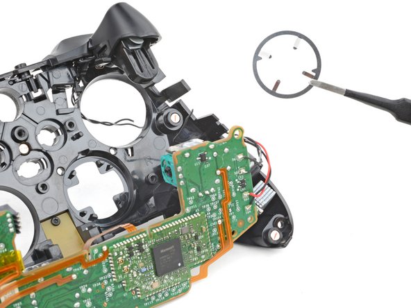

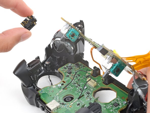

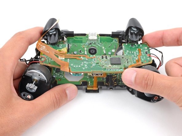

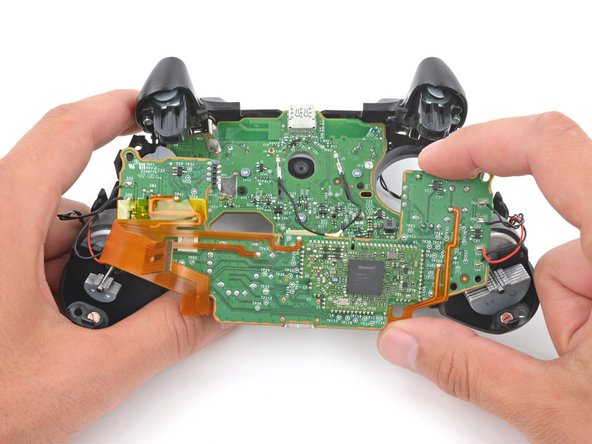

  21. Scuf Instinct Pro Buttons Replacement, Reposition the thumbstick board: stap 21, afbeelding 1 van 3 Scuf Instinct Pro Buttons Replacement, Reposition the thumbstick board: stap 21, afbeelding 2 van 3 Scuf Instinct Pro Buttons Replacement, Reposition the thumbstick board: stap 21, afbeelding 3 van 3
    • Delicate wires are soldered to the outer edges of the thumbstick board. Be very careful during this step to avoid tearing the wires from the board.
    • Gently lift the thumbstick board and reposition it over the bottom of the midframe so the board is standing upright.
    • The headset jack may fall out, as nothing is securing it to the charging board anymore.
    • Use the alignment posts to orient the board.
    • When lowering the board into place, make sure the black antenna cables don't get stuck under the board.

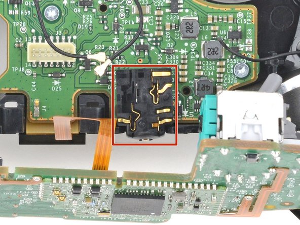

  22. Scuf Instinct Pro Buttons Replacement, Remove the headset jack: stap 22, afbeelding 1 van 3 Scuf Instinct Pro Buttons Replacement, Remove the headset jack: stap 22, afbeelding 2 van 3 Scuf Instinct Pro Buttons Replacement, Remove the headset jack: stap 22, afbeelding 3 van 3
    • Remove the headset jack from the bottom right corner of the charging board.
    • Make sure the headset jack is properly oriented, with the socket on the bottom edge of the charging board and the gold contacts facing up.

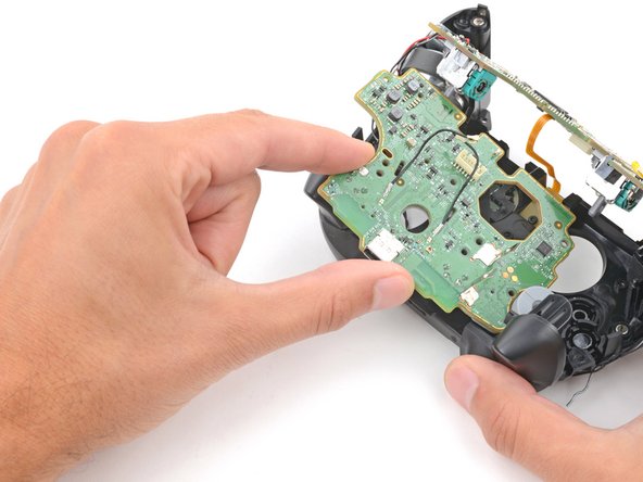

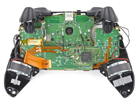

  23. Scuf Instinct Pro Buttons Replacement, Unfasten the charging board: stap 23, afbeelding 1 van 2 Scuf Instinct Pro Buttons Replacement, Unfasten the charging board: stap 23, afbeelding 2 van 2
    • Use a T6 Torx screwdriver to remove the six 7 mm‑long screws securing the charging board.

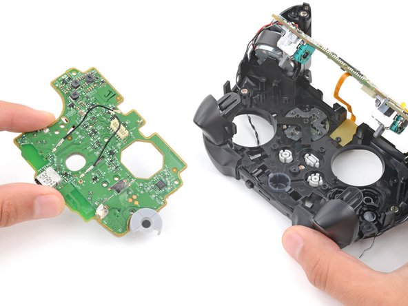

  24. Scuf Instinct Pro Buttons Replacement, Remove the charging board: stap 24, afbeelding 1 van 3 Scuf Instinct Pro Buttons Replacement, Remove the charging board: stap 24, afbeelding 2 van 3 Scuf Instinct Pro Buttons Replacement, Remove the charging board: stap 24, afbeelding 3 van 3
    • Lift the charging board over one of the triggers and remove it.
    • During reassembly, use the alignment posts to orient the board.

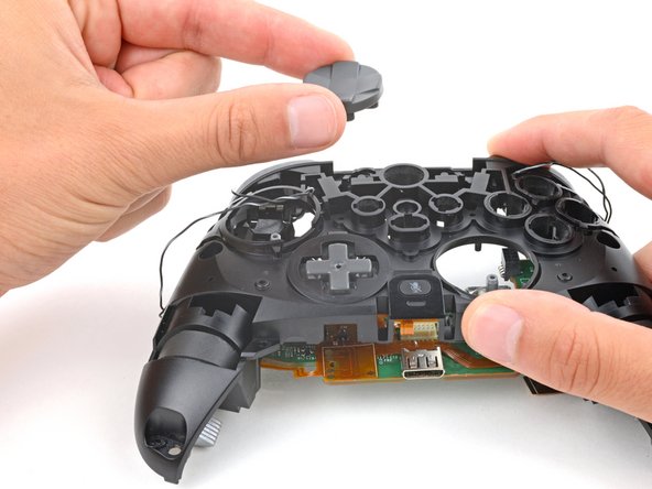

  25. Scuf Instinct Pro Buttons Replacement, Remove the buttons: stap 25, afbeelding 1 van 3 Scuf Instinct Pro Buttons Replacement, Remove the buttons: stap 25, afbeelding 2 van 3 Scuf Instinct Pro Buttons Replacement, Remove the buttons: stap 25, afbeelding 3 van 3
    • Use blunt nose tweezers to pull the buttons out of their recesses.
    • During reassembly, use the alignment tabs to orient each button in its recess. The buttons will only fit in their recesses when in the proper orientation.

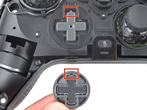

  26. Scuf Instinct Pro Buttons Replacement, Remove the D-Pad: stap 26, afbeelding 1 van 3 Scuf Instinct Pro Buttons Replacement, Remove the D-Pad: stap 26, afbeelding 2 van 3 Scuf Instinct Pro Buttons Replacement, Remove the D-Pad: stap 26, afbeelding 3 van 3
    • Weak magnets secure the D-Pad button cover.
    • Lift the D-Pad button cover straight up to remove it.
    • Use the alignment cutout on the bottom of the cover to orient it.
  27. Scuf Instinct Pro Buttons Replacement: stap 27, afbeelding 1 van 3 Scuf Instinct Pro Buttons Replacement: stap 27, afbeelding 2 van 3 Scuf Instinct Pro Buttons Replacement: stap 27, afbeelding 3 van 3
    • Use blunt nose tweezers to remove the plastic securing bracket, D‑Pad button, and metal washer.
    • Make sure the washer's arms are angled upward before putting it in its recess.
    • Use the alignment tabs to orient the washer and D-Pad button.
