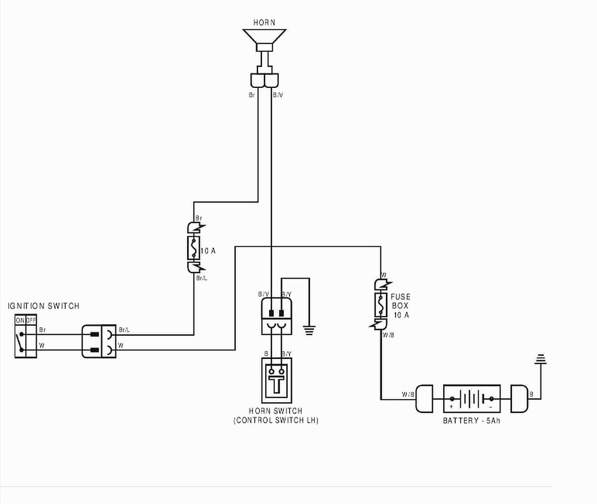

@roshan51846 you are not giving us a lot of information here. I would expect more than just a few words if you are seriously trying to fix your motorcycle. Anyhow, there should be a wiring harness connecting this all together. IF there are individual things that are disconnected or not working, use the schematics to trace the errors.
