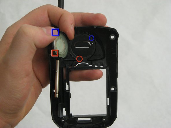

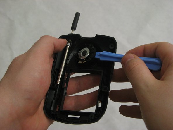

  • Insert a plastic opening tool between the speaker and the case. Then pry the speaker out.
  • To reinsert the speaker, align the blue notch to the blue stud. Then the red notch to the red stud. As shown in the last picture.
