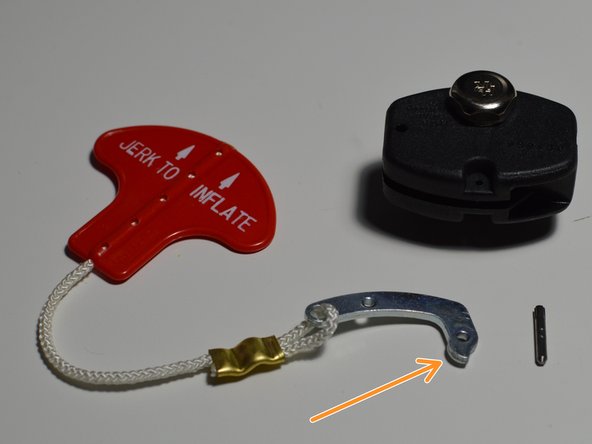

  • The lever is installed with one pin pressed into place
  • A cam can be seen on the end of the lever, this causes the pin to only be fully extended in one position
