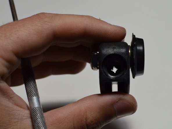

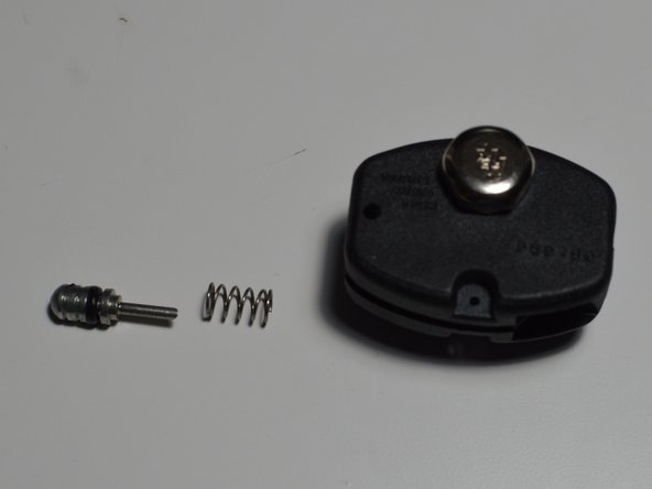

  • The piercing pin is installed going through the entire body of the inflator.
  • With a scribe it can be removed. There are 3 pieces: the pin, a spring (causing the pin to return after use), and an O-ring to only allow the air one path into the airbag.
  • With the pin removed a path is visible from where the CO2 bottle mounts to the lever.
