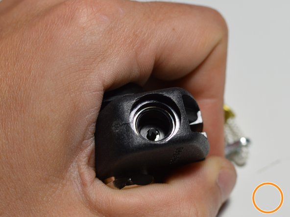

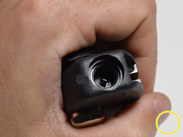

Inflation Mechanism
  • Prior to pulling lever:
  • Mid pull on lever
  • Full pull on lever
  • When pulling lever a piercing pin goes from retracted, to fully extended, to retracted again. This opens the CO2 bottle and then clears the opening to allow quick inflation.
