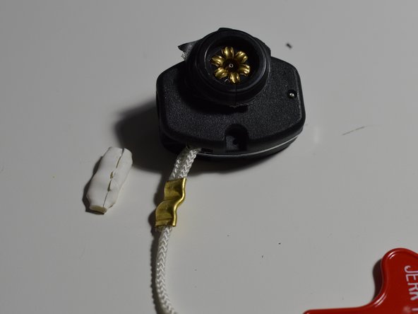

Pull mechanism
  • To inflate the tab is pulled which moves a lever, which in turn pierces the CO2 bottle (more in the next step)
  • A shear pin going through the main body and lever prevents the lever from falling open. To break the pin a "jerk" is recommended
  • The second picture shows heat shrink over a crimp, this is to prevent any abrasion against the inflated life jacket
