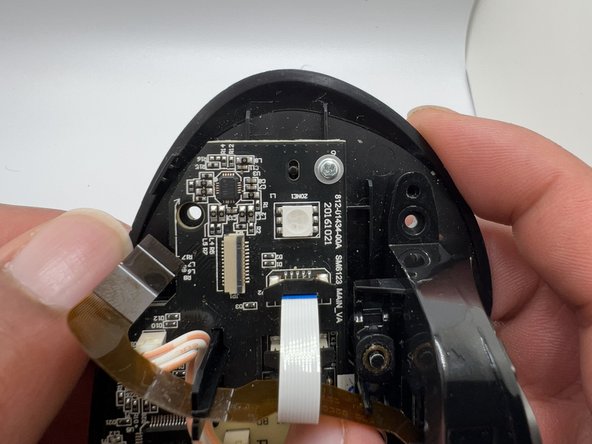

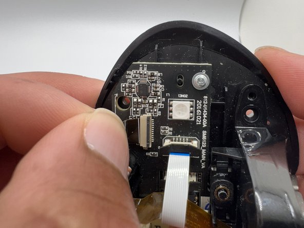

  • Lift the locking mechanism on the Key Slider assembly ribbon cable connector with a plastic spudger.
  • Pull the Key Slider assembly ribbon cable gently to disconnect it from the main board.
