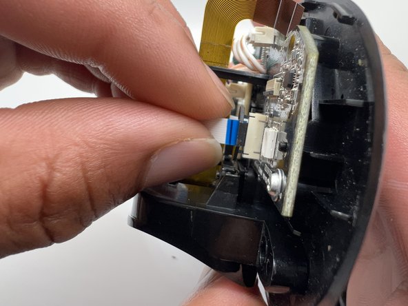

  • Lift the locking mechanism on the auxiliary switch board ribbon cable connector with a plastic spudger.
  • Pull the ribbon cable gently to disconnect from the main board.
