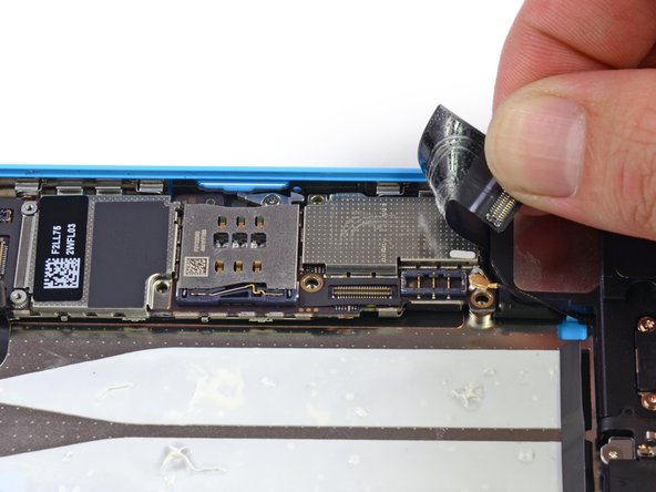

    • As we go to remove the antenna connectors with our trusty spudger, we notice something we haven't seen in any recent iPhone: adhered connectors.
    • In case our years of teardown tirades were too subtle, we'll reiterate: we strongly dislike glue.
    • On a scale from 1 to taking selfies with an iPad, strongly adhered devices rank right up there with proprietary screws and people who don't appreciate cheesy puns.
    • Annoying adhesive aside, we get to removing the logic board from our little blue iFriend.
