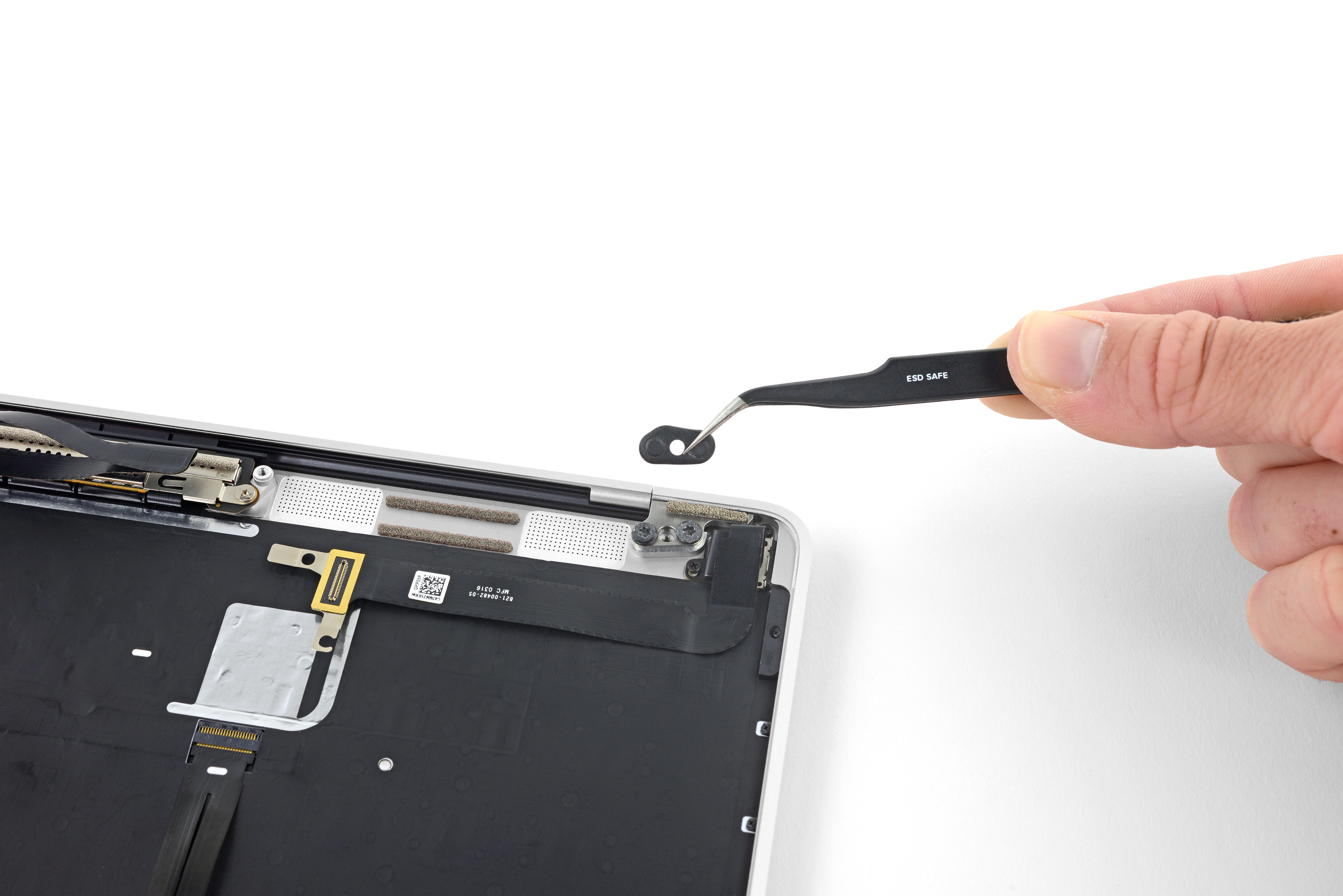

    1. Retina MacBook 2016 Display Assembly Replacement, Display Assembly: stap 30, afbeelding 1 van 3 Retina MacBook 2016 Display Assembly Replacement, Display Assembly: stap 30, afbeelding 2 van 3 Retina MacBook 2016 Display Assembly Replacement, Display Assembly: stap 30, afbeelding 3 van 3
      • Remove the two 3.3 mm T5 Torx screws securing the display cable assembly.
      • Take care not to lose the small retaining bracket located under the right screw. If it comes loose, note the orientation shown here for reassembly. The small tab on the outer left edge should be hooked under the perforated metal shield.
      Vraag FixBot
      Voeg opmerking toe
