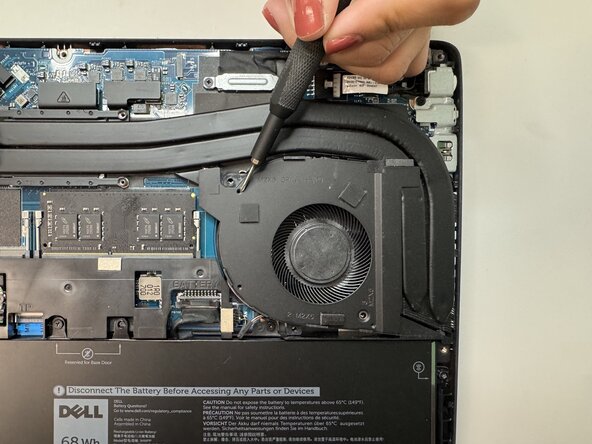

  3. Dell Precision 3541 Fan Replacement: stap 3, afbeelding 1 van 3 Dell Precision 3541 Fan Replacement: stap 3, afbeelding 2 van 3 Dell Precision 3541 Fan Replacement: stap 3, afbeelding 3 van 3
    • Locate and unscrew the fan The fan is located on the top right of the bottom of the laptop.
    • The fan is located on the top right of the bottom of the laptop.
    • Once you have located the fan you should see it held in place by 3 small screws and 3 larger screws as well.
    • To unscrew, you must use a #000 or 1.5mm cross-head screwdriver to unscrew the screws.
    • Once you have removed all of the screws, locate the fan cable which is a long wire running along the bottom of the computer that is connected to the fan.
    • To remove these screws, you must change to a #00 or 2mm cross-head screwdriver.
    • Then, remove the 4 screws (2 on each side) from the wire to remove it and then carefully remove the fan.
