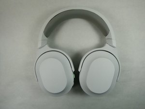

My power button got stuck
I dropped it then the power button feels loose, I opened up the device where the button is but can't tell what's wrong with it

The switch itself shattered and is in tiny pieces. I need a new switch. What do I do?

I had this same problem after I dropped my headset. I took it apart and also saw nothing to seemingly be wrong but I tried to wiggle the little black button and it eventually popped out and the button is no longer stuck and is tactile again.
