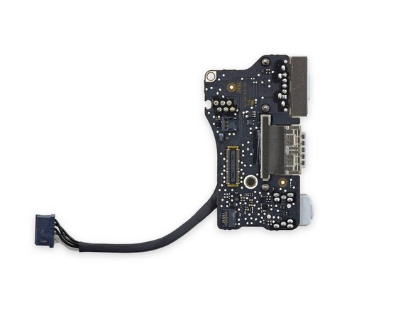

MacBook Air 13" Early 2015 Teardown: stap 0, afbeelding 1 van 3 MacBook Air 13" Early 2015 Teardown: stap 0, afbeelding 2 van 3 MacBook Air 13" Early 2015 Teardown: stap 0, afbeelding 3 van 3
  • Continuing the trend of sameness, the I/O board is nearly identical to the one found in the MacBook Air 13" Mid 2013, even down to the audio codec IC:
  • Cirrus Logic 4208-CRZ HD audio codec, likely similar to the 4207
