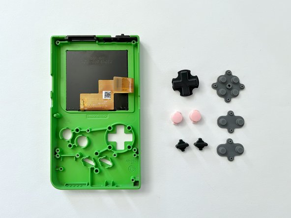

Buttons and Membranes
  • Remove the rubber button membranes (x3) from their pockets.
  • Remove the buttons and the D-pad from the shell with tweezers or by hand. If you flip the shell over, they will fall out freely.
  • The buttons will come out easily once the membranes are removed.

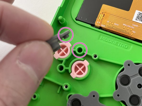

  • When re-attaching the rubber button membranes, be sure the positive features on the membranes seat securely into the pockets on the shell.
