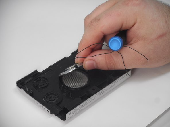

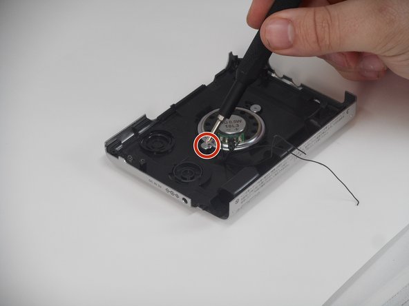

  • Remove the two 3.1 mm Phillips #00 screws.
  • Gently lift and remove the speaker from its slot.
