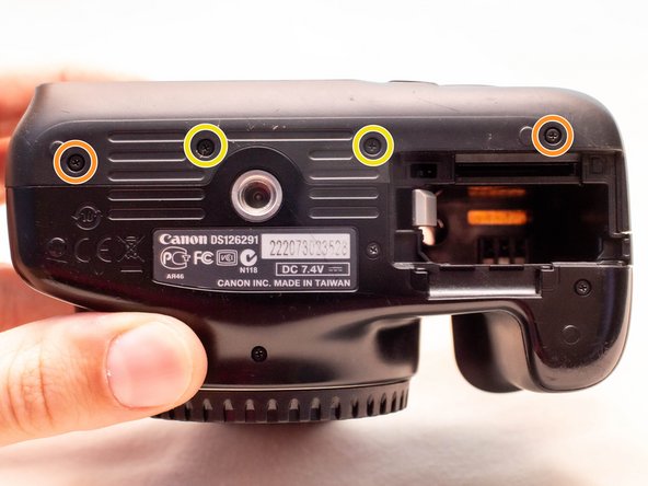

  • Remove the battery door.
  • Open the battery door to about a 35° angle.
  • Pull the battery door straight outwards.
  • Remove the following screws from the bottom of the camera:
  • Two M1.7x4.5mm JIS #000 screws
  • Two M1.7x3.0mm JIS #000 screws
