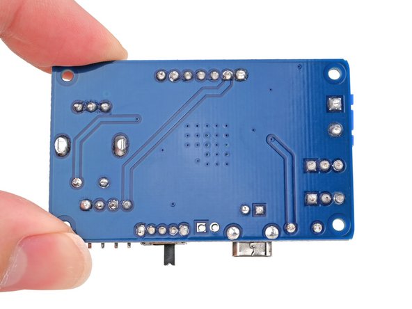

Clean the board
  • This is a great time to clean up any residue left from the solder. Apply some isopropyl alcohol to the solder joints and wipe with a lint-free cloth to soak up the flux and alcohol residue.
