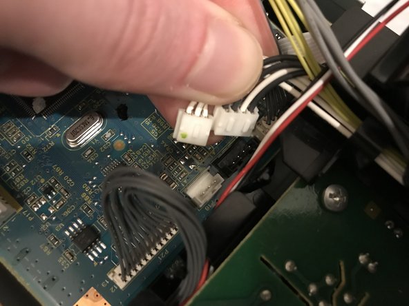

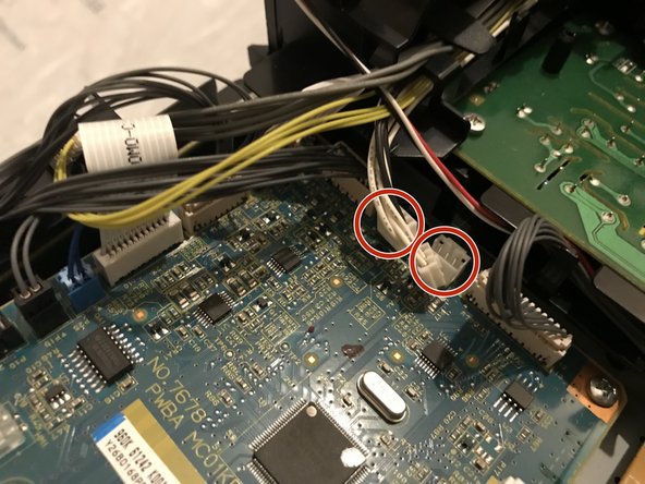

Remove fuser unit
  • Unplug the fuser power cable by squeezing the top of the retaining clip and pulling the connector up from the power supply board.
  • De-route the fuser power cable and remove from the cable restraint.
  • Pull up on the two fuser unit control cable connectors to unplug from the control board.
  • De-route the two sets of control cables from the control board to the fuser unit and remove from the wiring harness.
