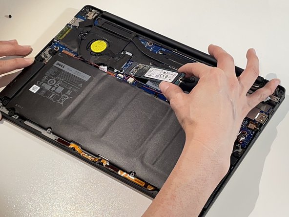

Slide the new SSD into the slot at the same angle used when removing the old one.
Make sure to align the notches on the SSD correctly with the tab openings of the slot to avoid damaging the SSD and the PCIe slot.
Press down on the SSD gently to hold it down.
