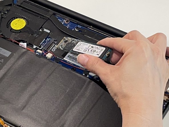

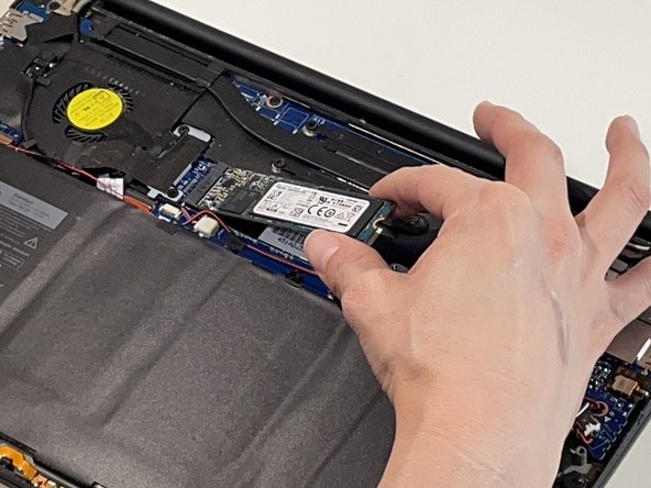

  • Disconnect the battery before removing the SSD.
  • Use the JIS J0 screwdriver to remove the single 2 mm screw securing the existing SSD.
  • The SSD will automatically "pop up".
  • Gently slide it out from the socket.
