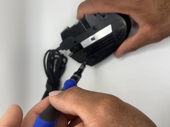

  • Unscrew the four 8.9 mm bottom screws with a JIS #00 screwdriver.
  • Loosen the keyslider lock with a 2.5 mm hex screw driver.
