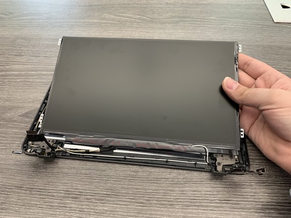

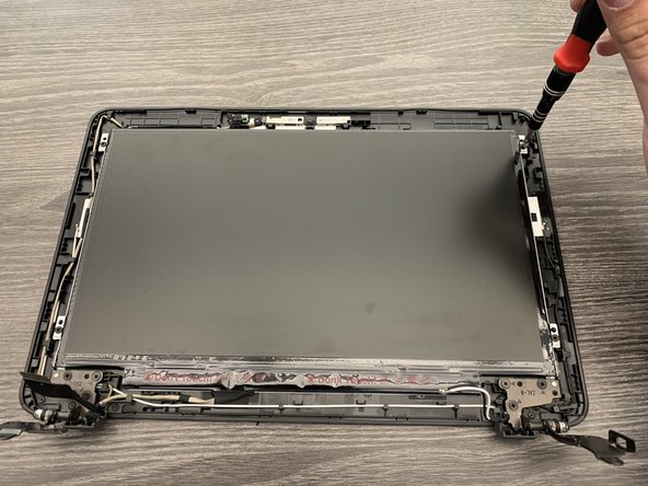

  • With the bezel removed, we can start working on getting our screen out.
  • On this model, there are only 4 Phillips head screws holding the screen in place. Once these screws are taken out, we will need to flip the screen on its front.
  • The screen is still being held in place by the display cable behind the screen.
