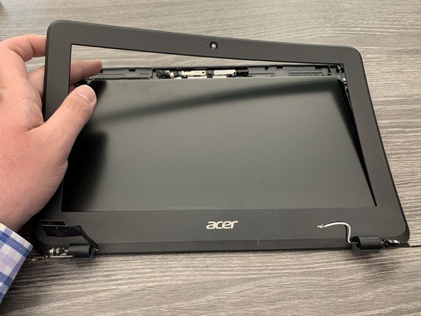

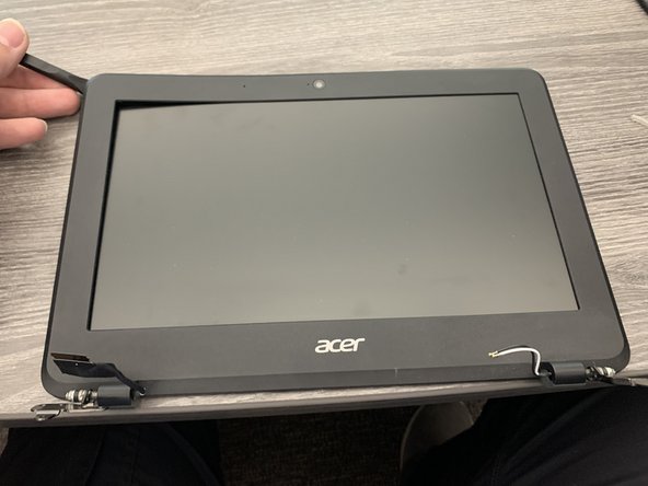

Stap 19
Acer Chromebook 11 C732 Teardown: stap 0, afbeelding 1 van 3 Acer Chromebook 11 C732 Teardown: stap 0, afbeelding 2 van 3 Acer Chromebook 11 C732 Teardown: stap 0, afbeelding 3 van 3
  • Now that the bottom half of the device is done, we can finally look at the screen assembly.
  • Getting into the assembly only requires a spudger. Once you have released the first tab, you can easily use your hands to remove the bezel.
