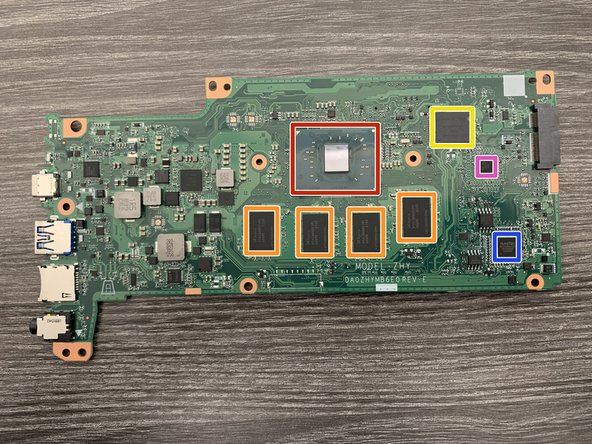

  • Front side of the motherboard:
  • Quad-Core Intel Celeron CPU N3350 (labeled as (H46417 01 E88)
  • SanDisk 32 GB eMMC Memory (labeled as SanDisk SDINADF4 - 32 GB)
  • SKhynix 4 GB RAM (labeled as SKhynix H9HCNN8KUML)
  • NUVOTON EC Micro-controller (labeled as NPCX588GGA0BX)
  • TPM (H1 Secure Microcontroller)
  • While it is nice to not have to deal with a mess of thermal paste, the thermal pad will need to be replaced since we removed the motherboard from the heat spreader.
