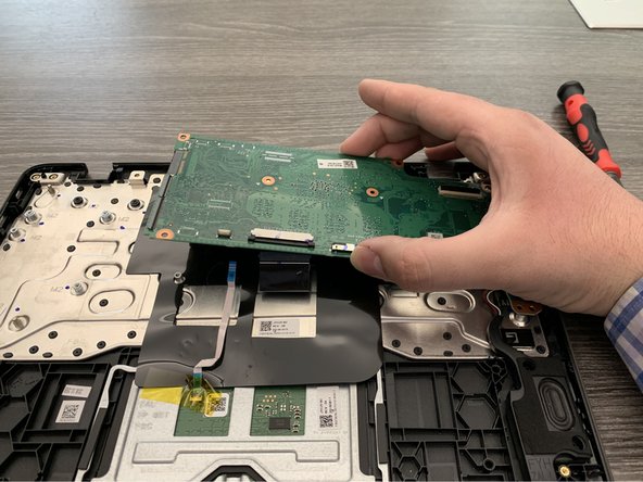

  • Once we have the hinges free, all we have to do is remove the three screws and lift the motherboard out.
