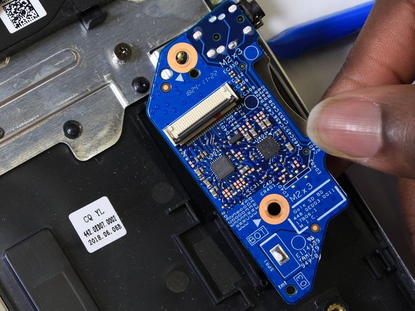

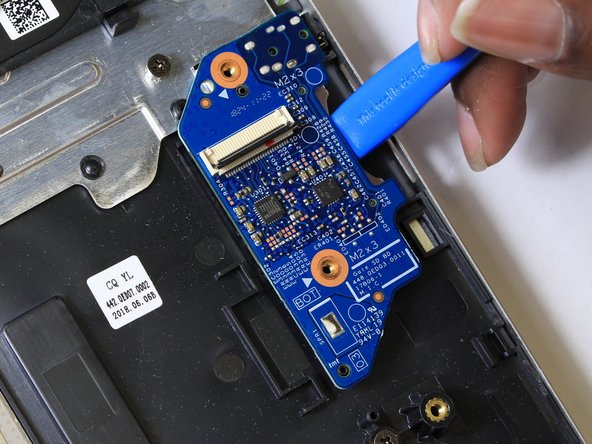

  • Using a Phillips #0 screwdriver, remove the two 4mm screws on holding down the SD card daughterboard.
  • Remove the SD card daughterboard.
