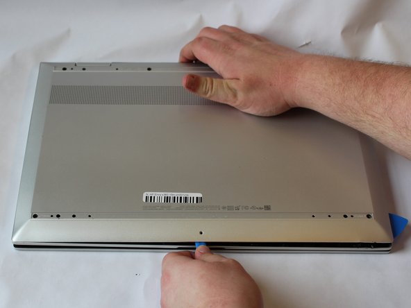

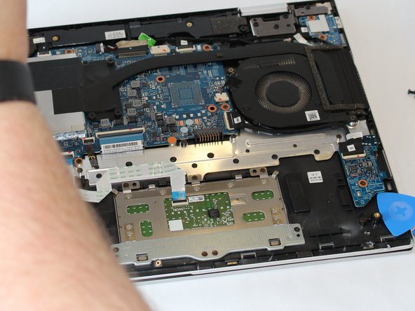

  • Pry open the back cover using the iFixit Opening Tool.
  • While using the tool, place a pick at each corner of the computer (be careful and do it slowly).
  • Once all the corners are slightly lifted, carefully pop off the back cover.
