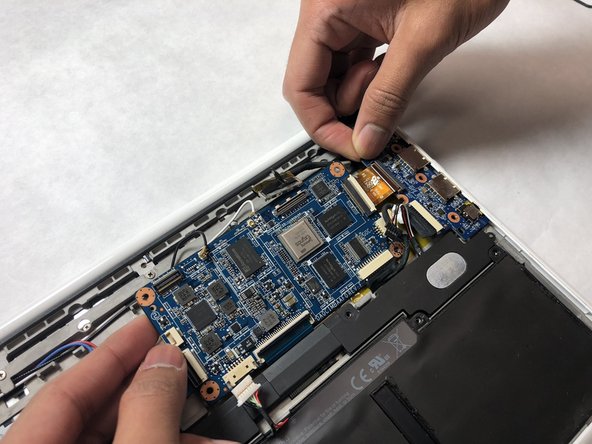

HP Chromebook CB2L Keyboard Replacement: stap 0, afbeelding 1 van 2 HP Chromebook CB2L Keyboard Replacement: stap 0, afbeelding 2 van 2
  • Remove the black and white antennae wires, the white ribbon cables, the large black connecter, and the speaker cable from the motherboard.
  • Grabbing the boards by the edges, remove the motherboard and audio/USB board.
