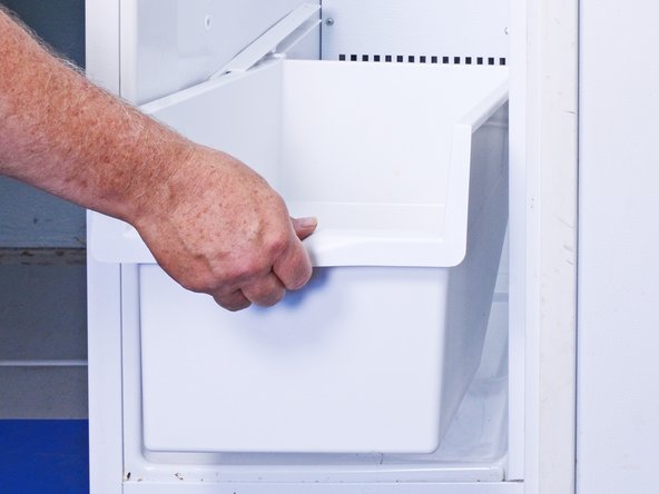

Pull the handle of the refrigerator door towards you to open it.
Lift the right edge of the shelf upward to tilt it.
Shift the shelf back to the right while keeping it tilted. It should now be released from its slot and you can remove it from the freezer.
Repeat these steps for any other shelves you wish to remove.
