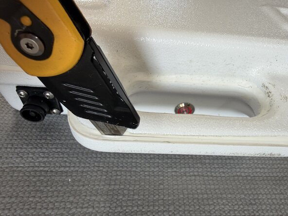

  2. BMS Replacement Replacement, Open the case: stap 2, afbeelding 1 van 3 BMS Replacement Replacement, Open the case: stap 2, afbeelding 2 van 3 BMS Replacement Replacement, Open the case: stap 2, afbeelding 3 van 3
    • Use a stanley knife to cut though the sealant of the battery case
    • Use caution when doing this

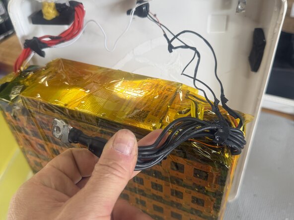

  4. BMS Replacement Replacement, Completely open the case: stap 4, afbeelding 1 van 3 BMS Replacement Replacement, Completely open the case: stap 4, afbeelding 2 van 3 BMS Replacement Replacement, Completely open the case: stap 4, afbeelding 3 van 3
    • Fully open the case
    • The glue is quite strong, use you hand inside to seperate the case from the heat shrink
    • Be careful to not damage the delicate switch wires

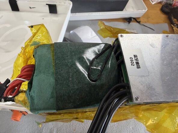

  5. BMS Replacement Replacement, Removing the battery pack: stap 5, afbeelding 1 van 3 BMS Replacement Replacement, Removing the battery pack: stap 5, afbeelding 2 van 3 BMS Replacement Replacement, Removing the battery pack: stap 5, afbeelding 3 van 3
    • Cut off the thick black shrink wrap
    • The main power cables and switch remain connected to the top cover.
    • Gently release and remove the switch cables from any adhesive so that they are not under stain when opening the case.
    • Rest the top cover on a box or similar to prevent staining the cables

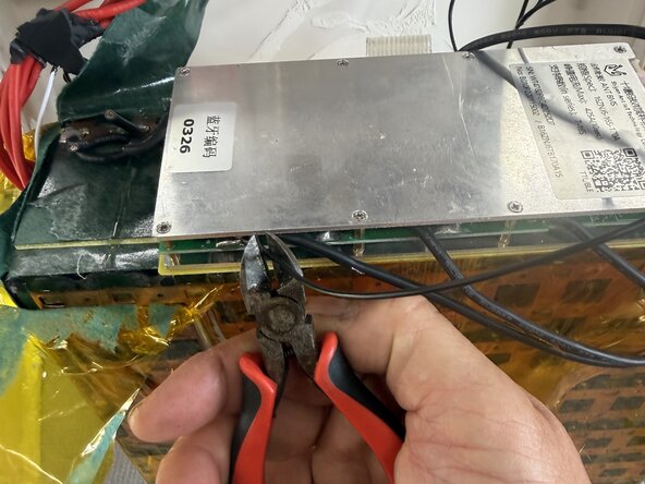

  9. BMS Replacement Replacement, Disconnect old BMS: stap 9, afbeelding 1 van 3 BMS Replacement Replacement, Disconnect old BMS: stap 9, afbeelding 2 van 3 BMS Replacement Replacement, Disconnect old BMS: stap 9, afbeelding 3 van 3
    • Unplug the 4 connectors from the BMS. these will all be reused. do not cut.
    • Cut the large main negative cables from the BMS. There are 3-4 at each end of the BMS.

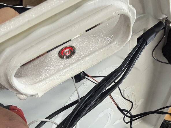

  10. BMS Replacement Replacement, Cut switch light wire: stap 10, afbeelding 1 van 2 BMS Replacement Replacement, Cut switch light wire: stap 10, afbeelding 2 van 2
    • Cut the black switch light wire as close to the BMS as possible.
    • A connector is soldered to this in step 14

  14. BMS Replacement Replacement, Switch light cable: stap 14, afbeelding 1 van 1
    • The light for the switch is illuminated when the pack is turned.
    • Solder or crimp the eye terminal to the switch light wire that was cut in step 10
