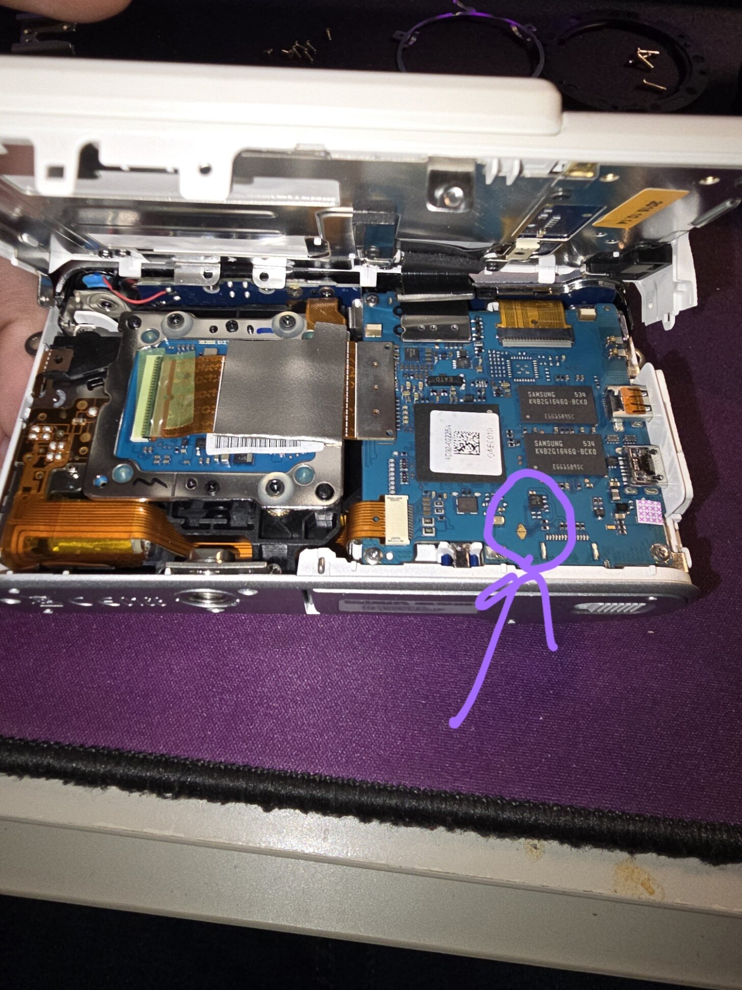

Samsung NX3000 camera stuck during Firmware upgrade.
Was doing an upgrade from 1.02 to 1.11 on Samsung NX3000 camera. but the process stuck just under half way. Now it seems ‘bricked’ and will not operate. Any ideas?

Hi there. I was able to fix this issue by performing a "hard reset" of the firmware. I followed the service manual from the NX300 for "7-4, how to recover the MAIN PCB" here: https://nxfiles.nx.tc/files/NX300/Servic... but bridge the 2 pads shown in the photo attached.
Afbeelding
Samsung NX300 Service Manual
Use this as a tutorial for disassembly: Samsung NX3000 Achterbehuizing Vervangen
For the firmware, obviously use the NX3000 firmware instead of the NX300. The firmware can be found here: https://nxfiles.nx.tc/files/NX3000/Firmw...
In case the links ever get lost, you gotta take apart the camera, bridge the 2 solder pads, and then press the power button, wait unil the indicator LED turns off.

I tried your method, but it didn't work. Could we talk about it in detail?
door
Would you mind clarifying one small detail for me? Should I simply place the DATANX3000.bin file on the root of the SD card, or do I also need to include an additional recovery file alongside it? I would be very grateful for your guidance—I just want to make sure I don’t miss anything before I proceed.
door
I have solved it and replaced it with a 512MB memory card in fat32 format
