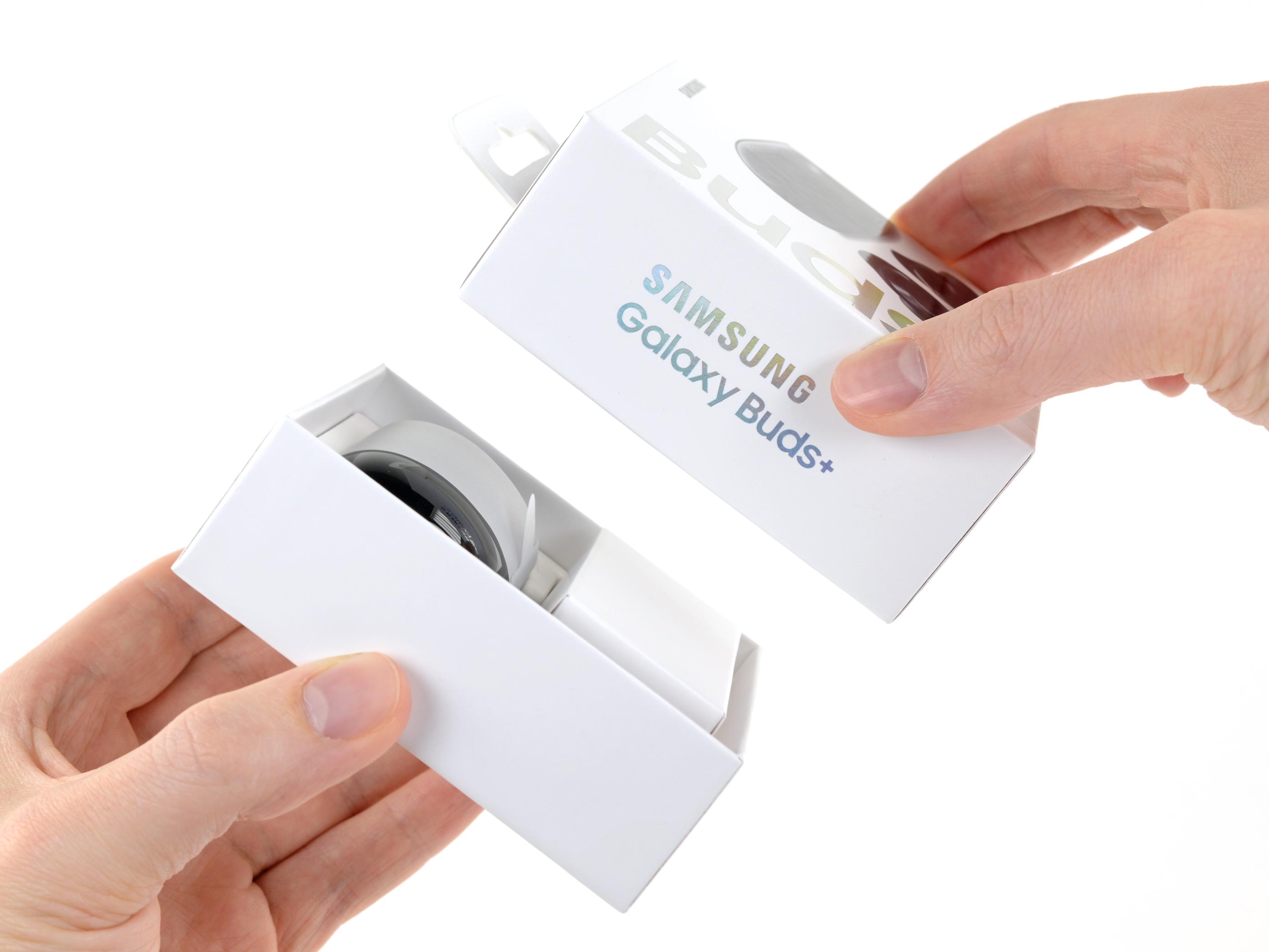

After this post was written, Samsung announced a new version of their Galaxy Buds, the Galaxy Buds+. Ours just arrived and we’re anxious to see how they compare to their predecessors. We’ll update this post with a summary of our findings, but be sure to subscribe to our YouTube channel to catch the full teardown, coming soon!
