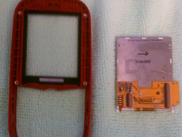

LCD comes out pretty easily Pry it from the bottom and work up the sides to release it if stuck
  • LCD comes out pretty easily
  • Pry it from the bottom and work up the sides to release it if stuck
  • The glass can be removed with a little heat from a heat gun or blow dryer
  • Pry it out from the outside edges working around carefully
