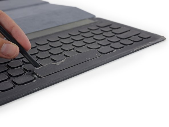

  • We peel up the top layer of mysterious fabric (we think it's nylon—our teardown engineer notes that it feels like a windbreaker) to find blank keys.
  • Perhaps Jony Ive was worried about your keyboard getting get too cold?

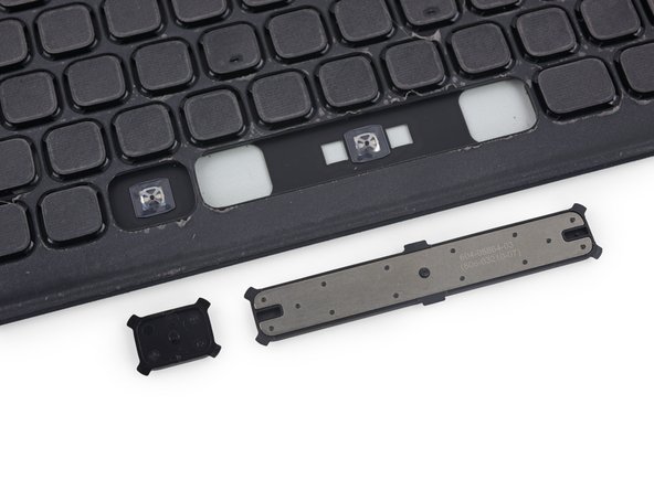

  • Moving past the fabric, we begin prying out the individual keys and get our first glance at the dome switches underneath.
  • As Apple stated during their keynote, these switches are the same as those found in the 2015 Retina MacBook.
  • One design choice we like is the placement of a stiffening weight in the spacebar.
  • The addition of this bar means the spacebar key can register a push no matter where you tap on it. No wobbly spacebar woes here.
