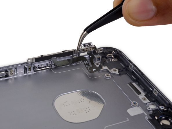

Remove the volume control flex cable.
During reassembly, put the volume control switch in place first, followed by the mute switch.
