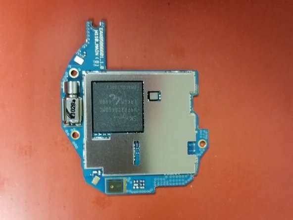

Stap 3
Disconnect the four electrical connectors from the board Orange - Battery connector
Removing the Board
  • Disconnect the four electrical connectors from the board
  • Orange - Battery connector
  • Blue - button and charging connector
  • Green - Backlight
  • Purple - O-LED Controller + Mic
  • Remove the three phillips screws securing the board down. Then lift the board off the base
