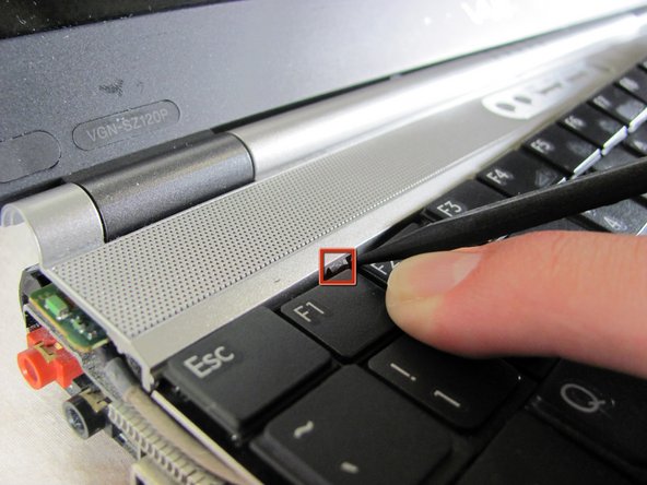

Stap 5
Push the tabs shown on both sides and the keyboard will pop up. A small flat-head might help you push the tabs.
  • Push the tabs shown on both sides and the keyboard will pop up.
  • A small flat-head might help you push the tabs.
  • Move the keyboard toward the mouse pad and gently pull up.
