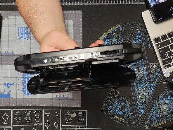

  • We are going to start by removing the back panel.
  • To do this open the panel and gently squeeze in the UMD tray until it pops up.
  • It should lay flat against the back panel while open if done correctly
