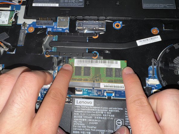

Push the clips outwards to release the RAM chip.

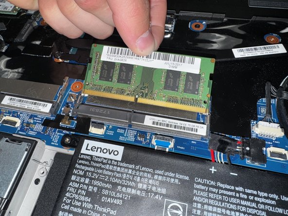

From there, take the chip out.
To add a new RAM chip, slide the chip in and press down to lock it in place with the clips.
