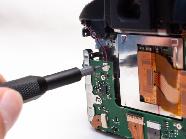

  • Disconnect the microphone cable from the main PCB board.
  • Position a flathead 2.5mm screwdriver between the main PCB board connector and the microphone connector.
  • Gently wiggle the flathead screwdriver back and forth until the microphone connector comes free.
  • If you do not have a flathead 2.5mm screwdriver, another similarly sized flathead screwdriver should work.
