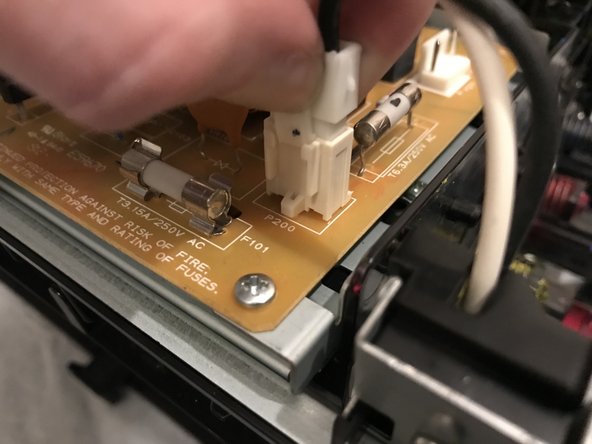

Dell 1350cnw Power Supply Board Replacement, Unplug electrical connectors: stap 0, afbeelding 1 van 2 Dell 1350cnw Power Supply Board Replacement, Unplug electrical connectors: stap 0, afbeelding 2 van 2
  • Unplug both the mains voltage connectors (power supply input and fuser unit supply) by pressing in the retaining clip on each connector and pulling up from the PCB to remove.
