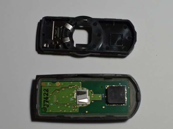

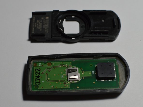

Removing Plastic Internals
  • The black plastic internals are clipped in and can be removed by gently prying the sides away from the inside. The internals house the battery and contacts the circuit board at two points to pass power to the board.
