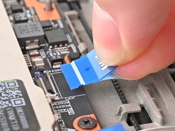

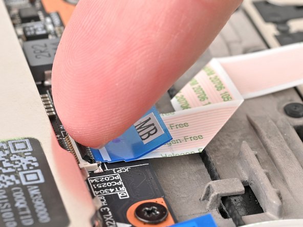

Lenovo ThinkPad T16 Gen 3 Trackpad Replacement, Disconnect the trackpad cable: stap 0, afbeelding 1 van 3 Lenovo ThinkPad T16 Gen 3 Trackpad Replacement, Disconnect the trackpad cable: stap 0, afbeelding 2 van 3 Lenovo ThinkPad T16 Gen 3 Trackpad Replacement, Disconnect the trackpad cable: stap 0, afbeelding 3 van 3
  • Use your fingernail or the flat end of a spudger to flip up the locking flap on the trackpad cable ZIF connector (labeled "JCP1").
  • Use tweezers or your fingers to gently pull the cable by its plastic pull tab out of its socket.
