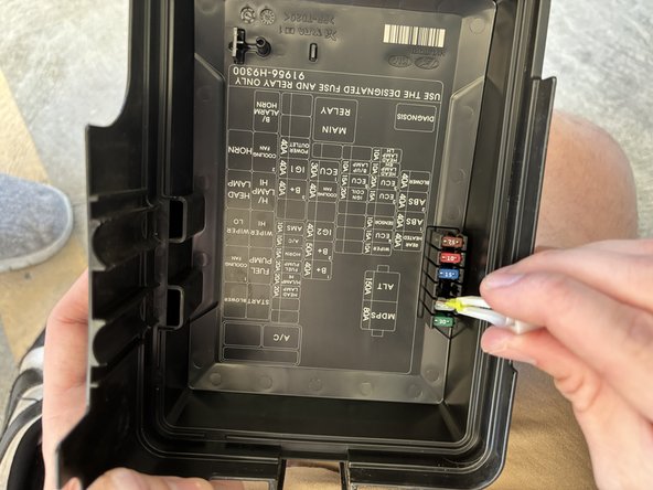

Retrieve a new fuse of the same rating, it should have the same series of letters and numbers on it as the one you are replacing (e.g. 20A, 10A, etc.).
The vehicle often comes with spare fuses in the cover of the engine compartment fuse panel, as pictured.
