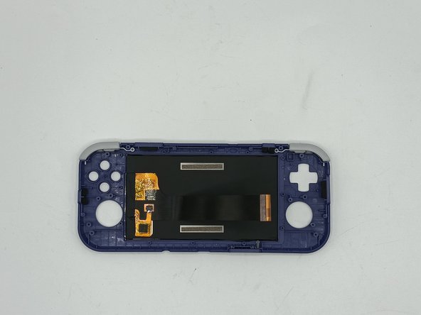

  • Remove the joysticks by unscrewing the two 3.5mm screws with a Phillips #00 screwdriver.

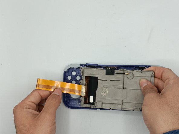

  • Remove the metal backplate from the front casing of the device by unscrewing the ten 3.5mm screws using the Phillips #00 screwdriver.
  • Carefully lift the ribbon cable from the metal backplate
