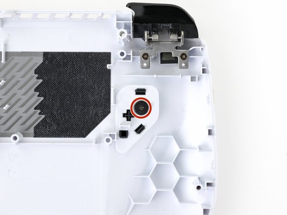

Unfasten the macro buttons
  • When removing the screws, be careful not to lose the springs under them. They can easily eject!
  • Use a Phillips #000 screwdriver to remove the 2.9 mm‑long screw securing each macro button (two total).
