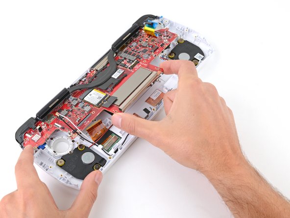

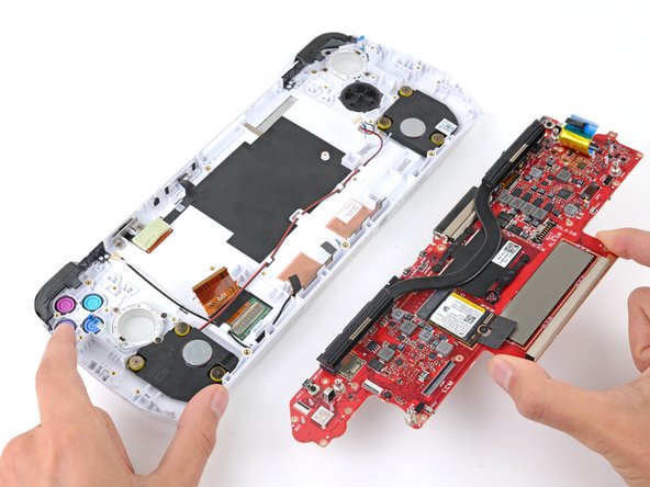

Remove the motherboard
  • If you have a microSD card installed, make sure to remove it before continuing.
  • With one hand, firmly secure your device.
  • With your free hand, lift the bottom edge of the motherboard and pull it towards the bottom of the chassis to remove it.
  • During reassembly:
  • With one hand, lift the top edge of your device so the actions buttons and D-Pad aren't touching your work surface.
  • Visually check that all the buttons are fully and properly in their recesses. If they aren't, they won't press correctly.
  • With your device lifted, use your free hand to slide the motherboard into place at a slight downward angle.
  • Make sure the bumper buttons near the upper corners go under the plastic bumpers and the ports along the top edge go into their cutouts.
