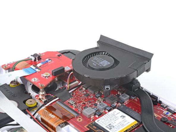

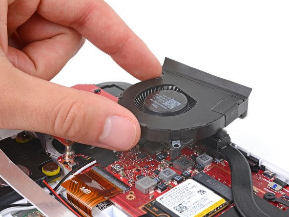

Reposition the right fan
  • Gently lift the fan and set it on top of the heatsink foam so you can access the fan cables.
  • Be very careful not to strain the cables, as they can easily be damaged.
