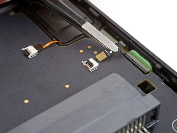

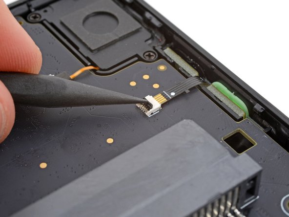

Disconnect the board
  • Use the tip of a spudger or a clean fingernail to flip up the hinged locking flap on the power and volume button cable ZIF connector.
  • Use blunt nose tweezers to pull the cable straight out of its socket.
